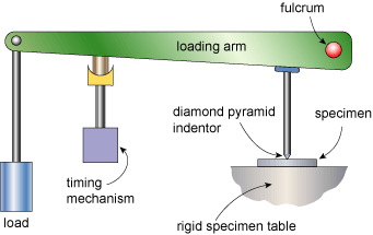

The Vickers hardness test operates on similar principles to the Brinell test, the major difference being the use of a square based pyramidal diamond indentor rather than a hardened steel ball. Also, unlike the Brinell test, the depth of the impression does not affect the accuracy of the reading so the P/D2 ratio is not important. The diamond does not deform at high loads so the results on very hard materials are more reliable. The load may range from 1 to 120kgf and is applied for between 10 and 15 seconds.
The basic principles of operation of the Vickers hardness test are illustrated in Fig.2 where it can be seen that the load is applied to the indentor by a simple weighted lever. In older machines an an oil filled dash pot is used as a timing mechanism - on more modern equipment this is done electronically.
Fig.2. Schematic principles of operation of Vickers hardness machine
As illustrated in Fig.3(b) two diagonals, d1 and d2 , are measured, averaged and the surface area calculated then divided into the load applied. As with the Brinell test the diagonal measurement is converted to a hardness figure by referring to a set of tables. The hardness may be reported as Vickers Hardness number (VHN), Diamond Pyramid Number (DPN) or, most commonly, Hvxx where 'xx' represents the load used during the test.
