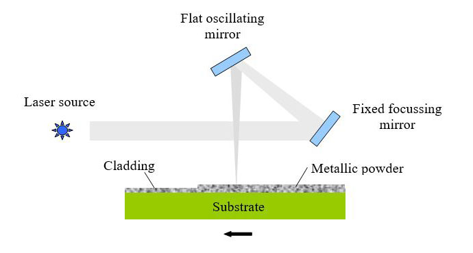

The descriptions in this article will primarily focus on conventional (and mainstream) laser cladding. However, there are newer and more advanced variants of the technology, including Extreme High-speed Laser Application (EHLA).
laser-cladding-diagram-1
In the EHLA process, the powder is fed into the line of the focused laser beam above the substrate. This ensures that the deposited material is already molten before making contact with the substrate, on the substrate a very shallow melt pool is still formed, allowing the deposited material to cool and solidify in contact with the underlying material, reducing the amount of heat reaching the component below and the depth of the dilution and heat effects. This small dilution forms the capability for producing much thinner coatings (20-300µm) that achieve desired chemistry within 5-10µm. This also forms the core of the high traverse speeds achievable with EHLA, which can exceed over 100m/min.
