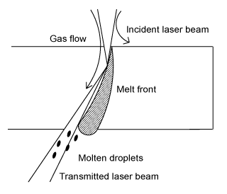

Fig.1 Schematic representation of laser beam cutting

Laser cutting is achieved by rapid removal of molten material from the beam/material interaction zone. Laser cutting is usually achieved using the continuous wave (CW) CO2 gas laser or the pulsed solid state laser; however, the cutting mechanism is different for the two. With the power densities available from modest CW CO2 lasers, the molten material can be removed by a high pressure gas jet (up to 20 bars nitrogen can be used). The effect of this, when combined with the fact that the laser melts only a small section of the workpiece due to its small spot, is to produce a narrow kerf width. Figure 1 shows schematically how the laser beam is absorbed on an inclined melt front within the kerf. The angle of this front varies with cutting speed and as the beam interacts at a high angle of incidence, the degree of polarisation of the laser beam becomes important. The molten material generated is blown out of the bottom of the cut with the high pressure N2 jet, (which also blows away any laser induced plasma). The melt is ejected as droplets, leaving a clean edge.
