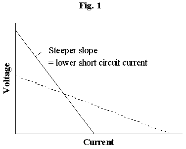

When MIG welding in the dip transfer mode, the welding electrode touches the weld pool, causing a short circuit. During the short circuit, the arc voltage drops to nearly zero. This change in the arc voltage results in a corresponding change in the welding curcuit current, the precise magnitude of which depends on the slope of the output characteristic (the resistance of the welding circuit), Fig. 1.
If the constant voltage power supply responded instantly, very high current would immediately begin to flow through the welding circuit. The rapid rise in current to a high value would melt the short-circuited electrode free with explosive force, dispelling the weld metal and causing considerable spatter.
