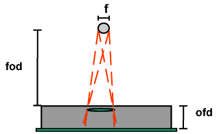

Definition: Sharpness of the dividing line between different density fields also referred to as Geometric Unsharpness (Ug) or Penumbra,
f     =     size of the radiation source
ofd     =     the thickness of the specimen being radiographed
fod     =     distance from the radiation source to the item being radiographed
