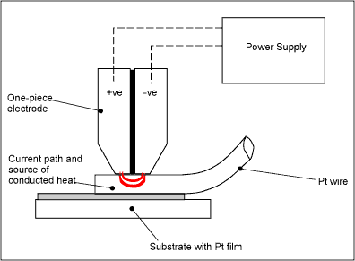

Thermocompression bonding of fine wires (<100µm diameter) is best achieved by using a light force resistance welding head fitted with a one-piece bonded electrode. Either DC or high frequency inverter type power supplies should be used as they offer fine adjustment of weld energy and time with excellent repeatability control via closed-loop monitoring systems. The figure below shows the set schematically.
The power supply delivers a pre-set pulse of energy for a pre-set duration (e.g. 15amps for 50msec) to the electrode via the connecting cables and the weld head. The weld head applies a downward force, which maintains intimate contact between the electrode, the wire and the substrate. The current passes from the positive electrode to the negative one via the wire, which generates heat both within the electrode tip and the wire. The weld is formed when the heat generated is sufficient to promote diffusion of the wire material into the pad and vice versa.
In order to maintain a consistent process there must be adequate control of the location of the wire relative to the electrode, and the condition of the substrate material. Variations in the surface condition, e.g. scratches or contamination can lead to wire burnout and electrode damage.
