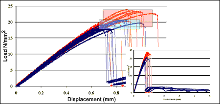

Experiments in which single lap joints were prepared with and without AdhFAST ® have shown that the statistical variation of peak failure loads and extension to failure for tensile testing were noticeably reduced using the new system. Typical data are shown below, where the 'area' of variation is sketched in for both types of joint (AdhFAST ® - Blue, no AdhFAST ®- Red).
In addition, failure load data obtained from joint pairs (where a single joint had been split into two equal halves along the long axis) showed a 50% reduction in the standard deviation between specimens prepared with and without AdhFAST ® respectively.
