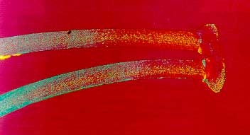

Simultaneous cutting and welding of plastic sheet
Fig.1. Cut/seal joint in 0.1mm polypropylene sheet using a conventionally focused spot
The benefits of welding and cutting plastics using lasers largely stem from the processing speeds available and the nature of the process. For high speed cutting, the laser beam is used at or near focus; for welding applications it is common to work in a defocused condition to produce a wide weld. By correct positioning of the focused spot, simultaneous cut-seal joints can be produced ( Fig.1.), but these are generally not particularly strong due to the narrow weld zone.
Fig.2. Cut/seal joint in 0.1mm polypropulene sheet using a diffractive optic
A third diffractive optic has been designed and manufactured to produce, simultaneously, a wide, low intensity energy distribution to make a weld but with a sharp, centre peak of intensity to produce a cut. When this optic was used to cut and weld two sheets of 0.1mm thick polypropylene, a consistent weld around 2.5mm wide was produced on each side of the cut (Fig.2.).
