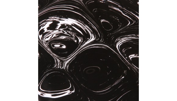

Carbon black is commonly used to protect polyethylene pipes from UV radiation when they are stored outdoors. However, if the carbon black is not fully mixed with the polyethylene during pipe extrusion, this can lead to windows in the pipe (areas in the pipe where there is no carbon black).
Windows in polyethylene pipe
The presence of windows can have a dramatic effect on the integrity of the butt fusion joints in the pipe.
