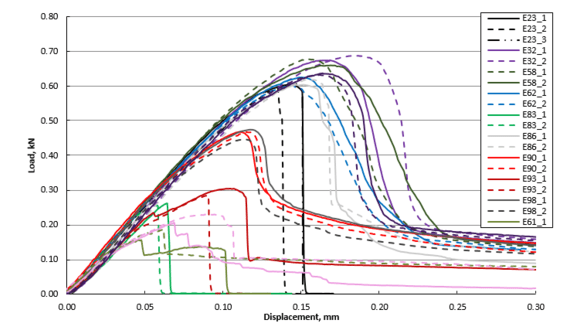

Our experts are working alongside Coventry University to conduct tests to quantify the quality of welded joints. These tests include four point electrical testing, tensile and fatigue testing and computed tomography (CT) scanning to provide maximum permissible defects in thin copper-aluminium joints, which are commonly seen in battery electric vehicles.
Current results show considerable variance in joint properties which can be used to provide best practice recommendations for welding of such materials to achieve desirable properties and avoid defects.
Figure 1: Weld joint tensile test results for varying weld parameter samples
