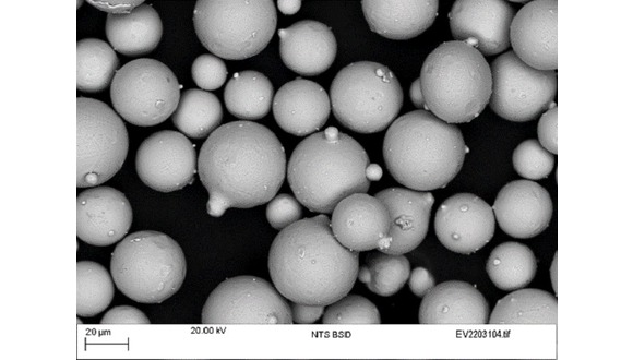

                             Fig 1. Powder morphology of PA Alloy 718

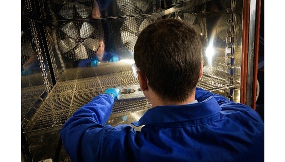

                             Fig 2. Weiss environmental chamber
