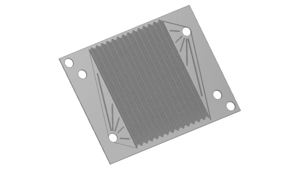

TWI has been working with an industrial partner to produce the photochemically etched shims, as shown in Figure 1, below:
Figure 1. CAD drawing of one of the ‘hot’ shims of the heat exchanger
Each layer incorporates zig-zag channels (semi-circular in shape, with a diameter of 500µm) and built-in headers. The design is a cross-flow concept, with each individual layer alternating between the hot and the cold working fluids and the microchannels stacked directly in line with each other.

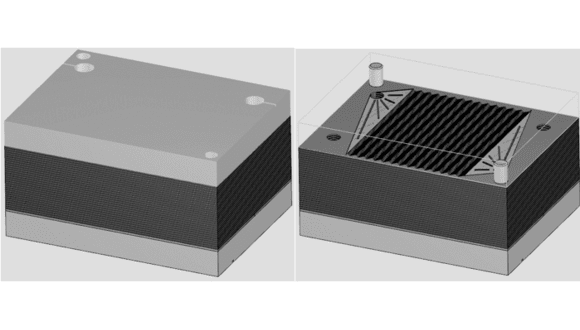

Figure 2. CAD images showing the diffusion bonded PCHE demonstrator
The shim stack consists of 30 hot and 30 cold shims situated between two thick end plates.
