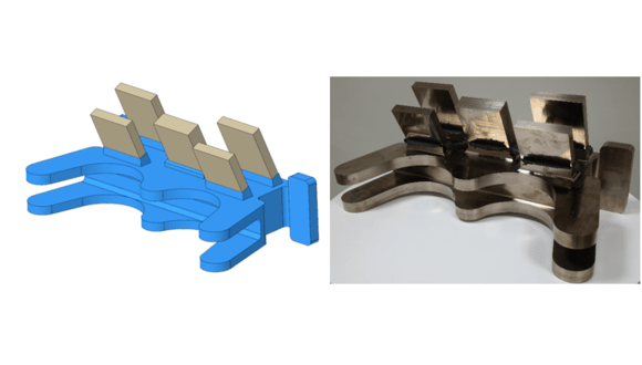

Investigation by TWI into Parker Lord’s rear engine fitting design revealed that using LFW to manufacture near-net-shape components would allow for a greater than 50% saving in material costs, production costs and an overall part cost compared to the current manufacturing approach.
Following completion of a design review, Parker Lord requested that TWI develop the LFW process implemented in the manufacturing of a full-scale demonstrator of the rear engine fitting.
TWI first defined the suitable welding parameters by conducting trials on forged Ti-6Al-4V blocks using existing tooling at TWI. With these in place, and a design established we were able to design a custom tooling solution for welding the rear engine fitting demonstrator. Finally, we were able to build the custom tooling solution, weld representative coupons and then complete the work by welding the lug preforms on the full scale demonstrator as requested.
Figure 1. Rear engine fitting full scale demonstrator - (Left) Computer aided model produced prior to project initiation. (Right) photographed following LFW completion. For scale the component width is approximately 600mm and the height approximately 400mm
