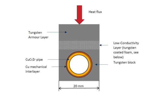

The design for the prototype limiters consisted of four off pure tungsten monoblocks that are joined to a single copper chromium zirconium tube with a copper insert (see image below).
Figure 1. Schematic of prototype limiter, courtesy of UKAEA
The development of the limiters included assessing the suitability of manufacturing the monoblock assemblies. This was done through a machining process to create a lower conductivity layer situated within the pure tungsten monoblock.
Several designs were created for the monoblocks, allowing UKAEA to assess the thermal conductivity properties of the differing designs

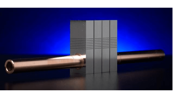

Radial diffusion bonding was used for the manufacture of these assemblies, bonding the components together to create a total of four layered armoured limiter demonstrators. You can see an image of a layered armour limiter assembly, below:
Figure 2. Image of an assembled layered armour limiter demonstrator

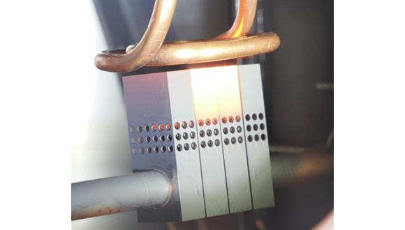

UKAEA has tested the most porous design at their HIVE facility (Heating by Induction to Verify Extremes), with results showing that the sample performed well after undergoing 500 cycles at a front face temperature of 1100°C. The limiter showed no signs of thermal performance degradation or ligament cracking, and UKAEA tests showed a drop in effective conductivity through the machined featured layer of around 60%, whilst also exhibiting no signs of debonding at the pipe interface.
You can see an image taken during the testing, below:
Figure 3. Image of an assembled layered armour limiter demonstrator during testing, courtesy of UKAEA
