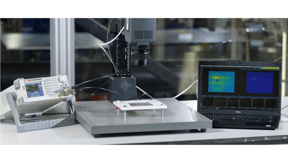

The project recently saw the in-line implementation of TWI’s dark lock-in thermography (DLIT) system on a VTT pilot test line. The DLIT system applies a square wave modulated voltage to the sample while it is imaged using the infrared camera (see Figure 1).
An in-house designed relay circuit acts as a switch to turn the power supply on and off according to the square wave generated, enabling high voltages to be applied using a low voltage signal. Along with thermal images, the camera also records the synchronised square wave reference signal that is generated using a signal generator.
Figure 1. The Dark Lock-in Thermography (DLIT) system developed at TWI

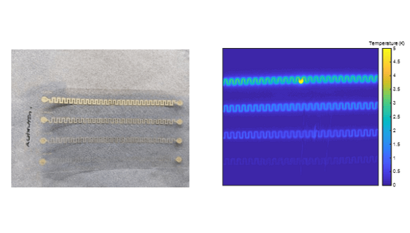

Laboratory testing detected scratches artificially introduced onto the sample provided by VTT to replicate defective printing. Figure 2 shows how the resulting signal amplitude and the scratched location is identified as a hotspot using the DLIT system.
Figure 2. Lab testing: Scratched VTT sample and DLIT amplitude image

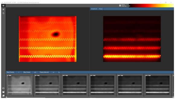

Custom GUI software was developed at TWI for the inline implementation, including two modes of thermography data acquisition and DLIT processing. Figure 3 shows the DLIT amplitude image.
Figure 3. TWI’s in-house GUI software

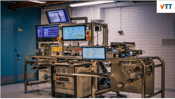

The in-line implementation of TWI’s DLIT inspection system on VTT’s R2R TESLA line is currently under development. The TESLA line is equipped with a series of pins for electrical measurement. It can be configured to apply periodical voltage inputs for DLIT in-line inspection system. Figure 4 shows VTT’s R2R TESLA pilot line.
Figure 4. R2R TESLA test line at VTT
