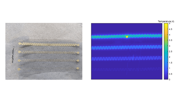

TWI led NDT inspection techniques for quality control measures of thin film photovoltaics. A dark lock-in thermography (DLIT) inspection system and the associated software was developed. The DLIT system was validated, allowing printing defects and variation in the print quality of conductor material to be detected on VTT’s thin film sample.  The DLIT setup developed at TWI is shown in Figure 3. The scratched sample the resulting amplitude is shown in Figure 4 and the scratched location shows up as hotspot that is clearly identifiable by using the DLIT system.

Figure 4. Scratched VTT sample and amplitude image

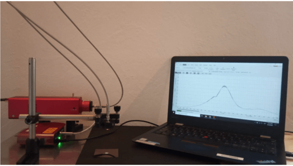

Meanwhile, SAL developed the inspection system and software based on Raman spectroscopy and Photoluminescence (PL) methods to estimate the composition as well as the expected performance. Two systems and software were tested on the CIGS samples from Solibro and TNO, yielding promising results. The proofs of concept of Raman spectroscopy and Photoluminescence (PL) were established. The actual realisation of the laboratory demonstrator for the PL measurement is illustrated in Figure 5 and Figure 6.
Figure 5. Lab demonstrator for the PL measurement

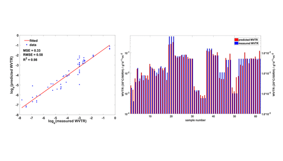

Fraunhofer developed an inline inspection system based on hyperspectral imaging (HSI) measurement for determination of barrier properties of barrier films, e.g., water vapour transmission rate (WVTR). As shown in Figure 7, the barrier properties (WVTR and pinhole density) of a large number of barrier films were measured using HIS, and machine learning methods were then applied to enable the prediction of the barrier properties of barrier films from the hyperspectral measurements. Figure 8 shows the matching by a comparison of predicted and measured WVTR of the investigated foils.

Figure 8. Comparison of the measured and the predicted WVTR

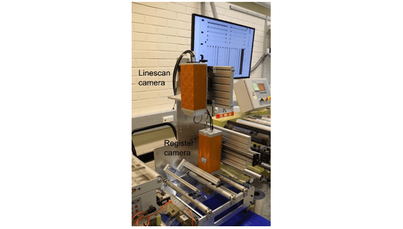

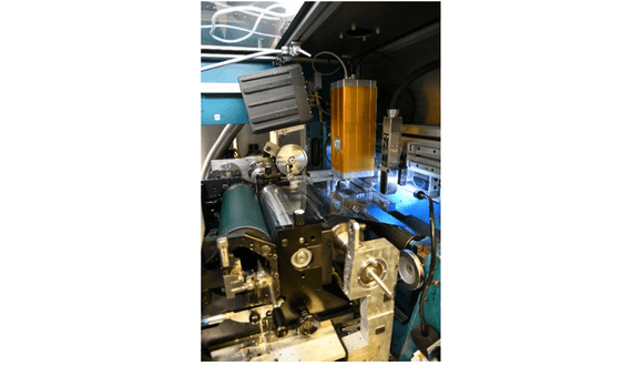

VTT developed in-line optical measurement system and acquisition software for quality control with a line scan camera and register accuracy measurement system at micrometer level. Figure 9 and Figure 10 shows the line scan camera and register camera implemented on the reeling machine and MAXI R2R pilot line at VTT’s premises.
Figure 9. Line scan camera and register camera implemented on a reeling machine
Figure 10. Register camera implemented on MAXI Pilot printing line

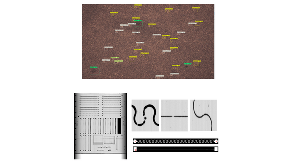

BUL developed automated defect detection algorithms using machine leaning and computer vision techniques. These methods have been validated using the optical images provided by Solibro (machine learning) and VTT (computer vision). The machine learning methods successfully automated the detection of different types of defects:
  • Solibro - optical absorber layer inspection - optical inspection of CIGS surface looking for local Inhomogeneity
  • VTT - Abnormalities in the optical inspection data of printed samples
Figure 12 shows successful automated defect detection of defects on CIGS and printed films based on machine leaning and computer vision techniques.
Figure 12. Machine learning based inspection on defects on thin films
