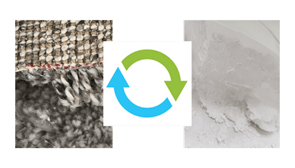

In the process of recycling the waste carpet, polypropylene is successfully separated via a mechanical process. The separated polypropylene is then purified through a subsequent chemical process, where pigments, additives and colorants are removed, leading to a virgin-like polymer powder.
Figure 1. Comparison of the purity of the product obtained and the product it came from
