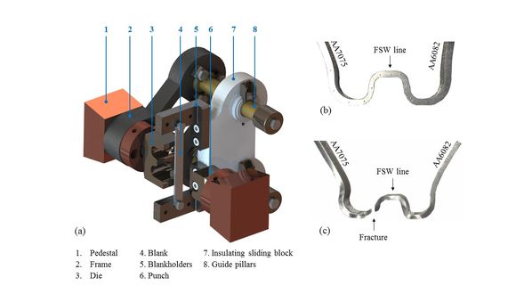

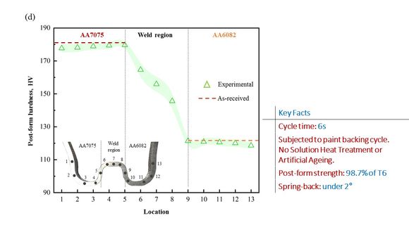

Aiming to expand further on these design freedoms, TWI and ICL have recently collaborated to form parts combining dissimilar aluminium alloys. Figure 1 shows an M-shaped demonstrator of a car body-in-white reinforcement, joining AA7075 and AA6082. Hardness measurements suggest that, following the paint baking cycle, the formed component reached over 98% of the original strength for each alloy.
Figure 1. M-shaped technology demonstrator: (a) FAST forming apparatus; (b) Successful forming using FAST forming conditions; (c) Fracture when attempting to form at room temperature; (d) Post- forming hardness distribution (adapted from Liu et al. 2020)
The FSW joining process proved essential in enabling this development, producing joints with the ductility required for enduring the rapid deformation rates involved during FAST forming.

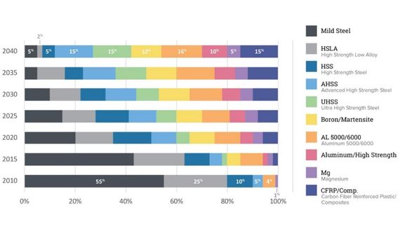

This technological milestone is of notable importance for the automotive sector. Aluminium alloy usage in vehicles is steadily increasing, with the majority of the metallic components obtained by sheet metal forming, extrusion or casting. Aluminium is predicted to be the prevalent material used in vehicle manufacture by 2040 (Figure 2). However, the relatively low formability of aluminium alloys at room temperature often limits their application, especially for high-strength, complex‑shaped stampings. There is also a clear trend to hybridise fabrication, by introducing higher strength grades from the AA2000 and AA7000 series, often joined to traditional options from the AA5000 and AA6000 series.
