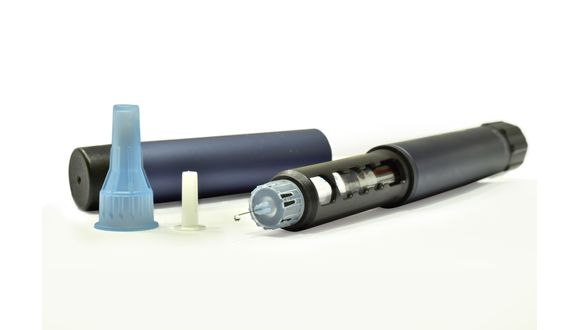

Figure 1. Intricate medical engineering applications
The technology allows for the joining of thermoplastic to any other material, using formed stakes to secure the materials together.
The equipment is able to join small or large pieces, without the need for bonding and, working closely with customers, Phasa are developing the technology further to join increasingly smaller components.

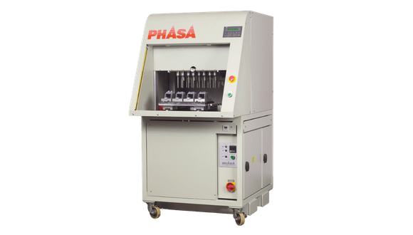

Figure 2. PHASA 20/40 Machine
Geoff Kelly, Commercial Director at Phasa explained, “The Phasa technology is an excellent solution for applications across the medical sector. Particularly, we've identified its potential use for attaching electronic circuit boards into medical devices and we've been working with customers to develop the technology to suit their joining requirements.”
He continued, “What clearly sets the Phasa process apart is that it leaves no plastic debris, which could happen with other methods such as ultrasonic welding. It also eliminates the use of adhesives, which is clearly beneficial for the environment when items are disposed of."
TWI is set to begin in-house trials of the innovative equipment and welcome those who are interested in the capabilities of this technique to contact us, below.
