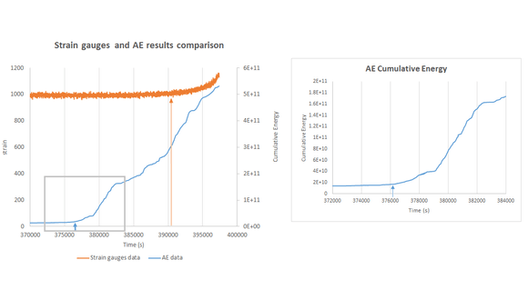

To simulate this environment, well casings were tested to failure for fatigue close to the resonance frequency, and monitored with acoustic emission sensors and accelerometers. The aim is to compare the two monitoring techniques for detecting cracking in well casings.
Two casing were tested, a plain healthy casing of 4.4m long and a casing with a VAM connector, and the results were compared to the readings from standard strain gauges, which are normally used for this type of resonance fatigue testing.
The casings were pressurised at 300psi, which produced a mean stress of 10MPa, using water that acted as a means of through-wall crack detection. The specimens were tested in a resonance fatigue test machine.  A rotating force was applied at one end of the specimen at a frequency of around 30Hz, which excites the specimen into the first mode of vibration.
A notch was opened on the plain casing at its highest stress area to control the location of the crack during the testing.
Both tests ran until through wall cracking occurred. Crack initiation was detected and recorded by all three techniques during both tests, however, acoustic emission sensors were able to detect the change earlier than strain gauges or vibration accelerometers.
In the case of the plain pipe, AE cumulative energy results showed that the technique was able to detect cracks approximately 3 hours 45 minutes earlier than strain gauges and vibration accelerometers.
