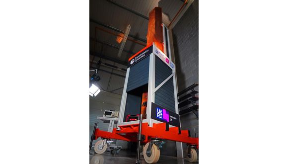

TWI has developed the prototype probe array and tests have shown a good level of performance. However, the array is being further refined and developed in order to achieve improved results. Transmission Dynamics have built a bespoke test rig (see Figure 1, below), which will enable representative laboratory tests to be conducted on the probe array in the coming weeks. A representative facility is now being built in a dry dock at a location operated by the ORE Catapult. This will allow the system to be trialled under conditions that replicate those in the real world, so that the performance of the system to detect defects can be verified.
Figure 1. PILESENSE Test Rig
