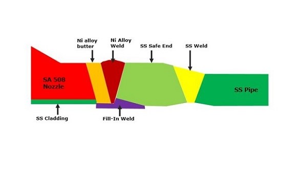

This has been a hot topic within the nuclear sector for a number of years, where ferritic steel reactor pressure vessels (RPVs), pressurisers and steam generators are joined to stainless steel piping system through complex dissimilar welding joints. These joints comprise several Ni Alloy buttering layers on the ferritic side, followed by a sequence of Ni Alloy and/or stainless steel arc welds, until finally reaching the stainless steel pipe (See Figure 1, below).
However, this joining method can create discontinuities in physical properties, such as thermal expansion/conductivity coefficients. The structural integrity of these welds and the subsequent safe operation of plant can be undermined by both primary water stress corrosion cracking (PWSCC) and thermal shock cracking.

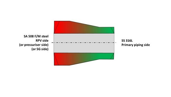

TWI is currently working on a project to solve this issue through the use of an additively manufactured transition piece, which includes a gradual change in chemical composition along the axial direction. The transition piece would use functionally-graded materials to produce a match to the chemical composition of the ferritic steel on one side and the stainless steel on the other (See Figure 2, below).

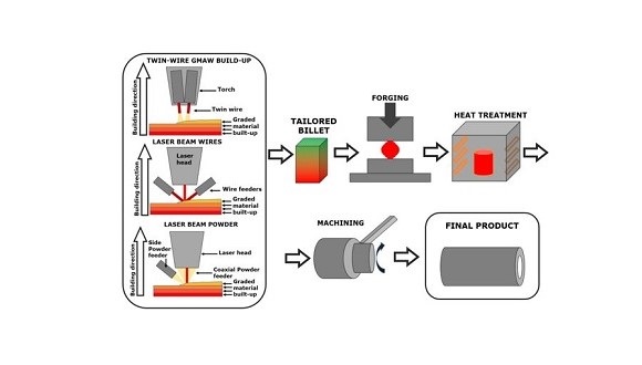

  • Wire plus arc additive manufacturing (WAAM) using two wires, with differentiated wire feeding rates
  • Laser beam additive manufacturing using either two powders, or two wires, similarly
The additively manufactured transition piece would then be hot forged and heat treated to create a finer microstructure, before being machined to the desired shape and dimensions (see Figure 3, below, for the manufacturing process).

Figure 1. Typical dissimilar welding design used in nuclear power plants
Figure 2. Schematic of a functionally-graded transition piece
Figure 3. Functionally-graded additively manufactured transition piece production route
