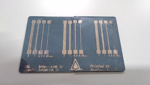

Laser sintering of nano inks

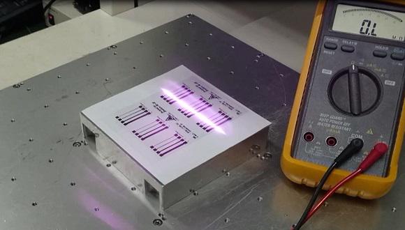

Laser sintering under processing

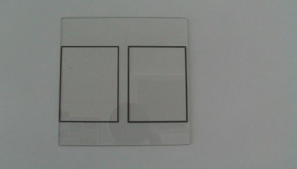

Glass sealing with frit glass
