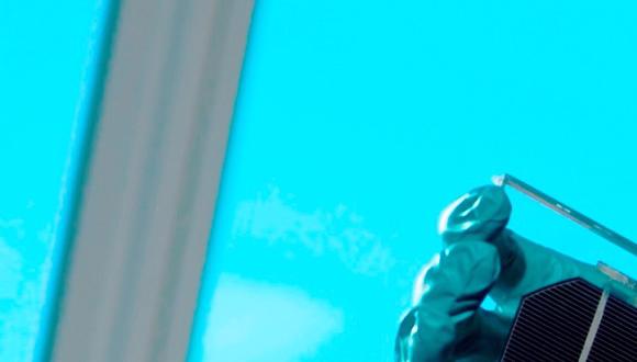

Four photovoltaic cells to which the SolarSharc® coating has been applied
