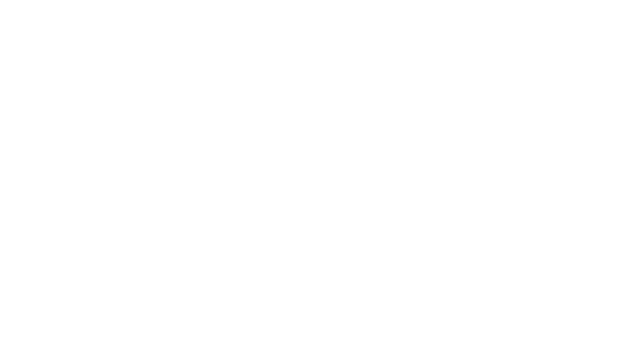

Image shows a schematic of a typical geothermal well casing made of carbon steel and in-filled with cement
