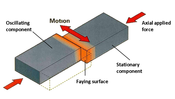

Linear Friction Welding (LFW) is a solid-state process that generates heat by rubbing components pressed under load using a linear reciprocating motion (Figure 1). Relying purely on interfacial friction and plastic deformation, LFW avoids the metallurgical drawbacks caused by melting the materials involved.

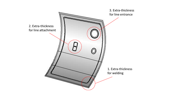

  • Joining pipeline attachment bosses on cryogenic fuel tanks for Ariane6, the newest generation of launcher developed by ESA and ArianeGroup (Figure 2). The cryotank body is made of large aluminium flat panels, which are cold formed and welded to produce the cylindrical structure. The panels feature a number of bosses to attach external pipes or inlets. These bosses are currently obtained by machining a solid plate comprising all the external features required (Figure 3). Using LFW to perform selective material additions would allow fabricating the main tank panels from thinner plates. This lowers raw material costs and plate sourcing lead-times.

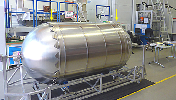

  • Connection of tabs on propellant fuel tanks for the Eurostar Neo satellite, the latest telecommunication platform manufactured by Airbus UK (Figure 4). Most propellant tanks are made of Ti6Al4V, comprising two domes and a cylindrical section, joined by means of Tungsten Inert Gas (TIG) or Electron Beam Welding (EBW). The tanks are integrated in the satellite structure using tabs, arranged in a polar, equatorial or pedestal configuration. Equatorial interfaces are the most complex, as they involve machining an integral ring comprising all tabs from a solid forged billet (Figure 5). Using LFW to join independent tabs machined from stock plate would enable substantial savings, as a dedicated forging for the tab ring will no longer be required.

Figure 1: Schematic illustration of LFW

Figure 3: Types of bosses found on cryotanks (courtesy of ArianeGroup)

Figure 5: Electron beam welding installation used to join the bipropellant tank for Orion's European Service Module. Detail of end skirt lugs to satellite propellant tanks (courtesy of Airbus UK)
