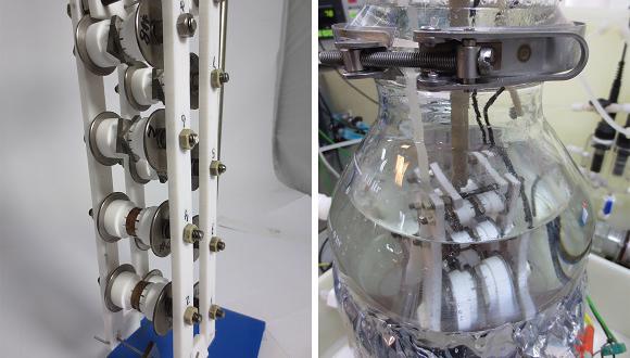

To test the suitability of materials for these kinds of service conditions, TWI built a set up to simulate the complex in-service environment of a shell-and-tube cooler. TWI then carried out testing of a Ni-based alloy (C276), typically used for this component, in order to assess its resistance to crevice corrosion in the simulated in-service conditions.
The material subject to testing was taken from a shell-and-tube cooler, including parent tubes, weld overlay from the tubesheet, and tube-to-tubesheet welds. The crevice assemblies were made with overlapping metal coupons to form combinations, e.g.: weld overlay-weld overlay specimens, that provide both a metal to metal crevice and typical castellated washer crevice. A very high torque was applied in order to represent as closely as possible the loading conditions the structure experiences in service.

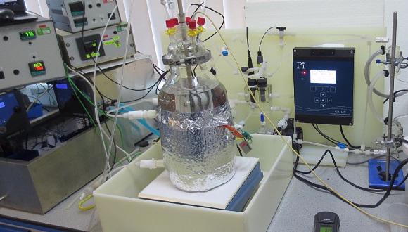

The test was carried out in artificial seawater (ASTM D1141) with 0.8-1ppm free chlorine and 7ppm dissolved oxygen (DO) at 80°C. 7 ppm is the dissolved oxygen content in the seawater as it enters the heat exchanger. The operation of the cooler presents a dynamic system that allows insufficient time for the dissolved oxygen concentration to decay to the significant lower equilibrium concentration (1-2ppm) at 80°C. A lab scale experimental set up was developed to be able to simulate a dynamic system as that of a shell-and-tube cooler and monitor its complex service environment. The scale experimental set up allowed simulation and settting of the dynamic operation of the shell-and-tube cooler at lab scale and to monitor and sustain its complex service environment throughout the long term duration of the test.

Figure 1. Assemblies of the test specimens that represent as closely as possible geometry and loading conditions that the heat exchanger experiences in service
Figure 2. Image of the lab scale experimental set up that sets, maintains and monitors the dynamic service environment of a heat exchanger (high temperature, high dissolved oxygen level and chlorinated seawater)
