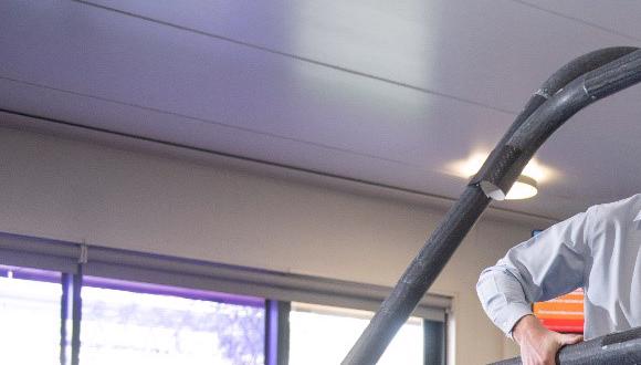

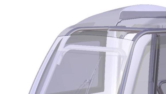

The cost-effective approach developed consists of an underlying tubular spaceframe chassis which provides the bodyshell with the required mechanical performance. In the demonstrator the beams are all the same outside diameter, but the wall thickness is tailored to give the optimum cost/weight and performance balance. This keeps the tooling costs low and the joining is standardised. The tubes are then joined through a combination of welding and adhesive bonding. In the case of significant damage any individual beam can be entirely replaced with a new one. Best of all the thermoplastic material is inherently recyclable.
