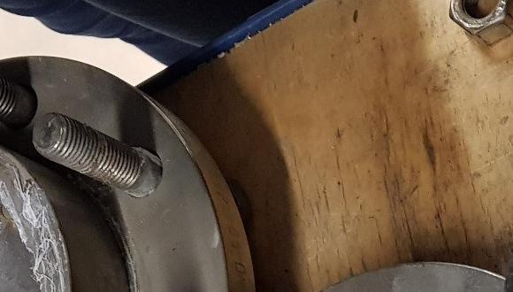

Low carbon steel disc severely corroded once exposed to geothermal environment
