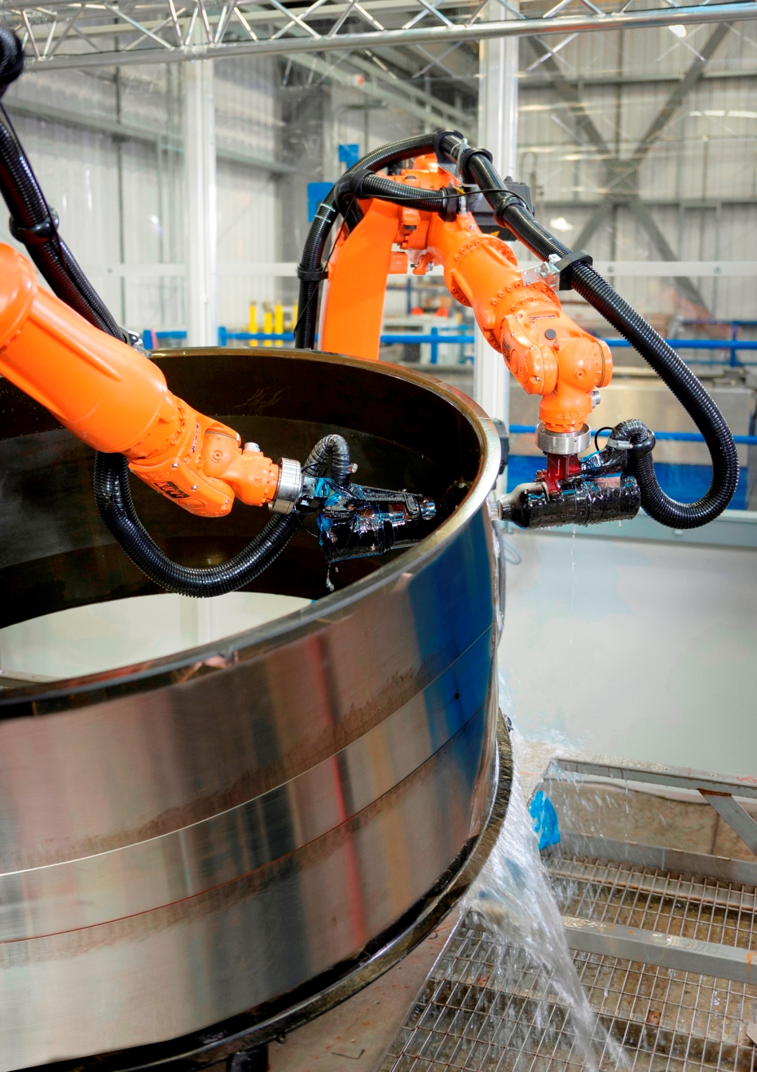

The first Intacom project was completed in November 2014 and was funded by a partnership of TWI, Bombardier, GKN and Rolls-Royce with support from the Welsh Government.  The resulting system; termed Intacom, delivered a prototype automated inspection cell using two 6-axis robot arms to inspect highly curved components in a fraction of the time usually taken by existing systems.  It incorporated highly advanced ultrasonic testing technology, developed in-house at TWI, to provide 3D imaging of parts that in many cases could not be inspected in any other way.  The industrial partners consequently funded a follow-on project that is aimed at developing solutions for further components using the existing cell.
The specific innovation at the heart of Intacom lies in two areas: firstly, the use of advanced phased array ultrasonic testing coupled with rapid communications between the robot controller and the ultrasonic system – this allows very rapid area coverage not achievable with single element ultrasonic based systems.  Furthermore, the use of advanced focal laws coupled with innovative end effector designs enables rapid scanning of difficult areas of geometry, such as tight radii – this would previously have required time consuming and error prone manual inspection.  Traditionally, inspectors would mark flaws directly on the surface by hand, and then transcribe the information into reports using photographs or sketches of the area.
The Intacom system uses unique 3D imaging to display scan results together with CAD imagery of the part, making the analysis of the data faster, more intuitive and less prone to errors.  Flaws can be imaged not only on the surface as with other systems, but also shown located within the structure of the part.  Full waveform ultrasonic data is captured, allowing analysis to occur after scanning is complete without the need for the part to be present, and produces a complete record of the inspection that is archived for future use.  This means that other parts can also be scanned whilst analysis of the results is taking place.  A suite of analysis and measurement tools enable flaws to be characterised, located and sentenced without the need to produce drawings or photographs.  Intacom is currently configured for ultrasonic testing using phased array transducers, however, the flexibility of the system means that it can also be easily adapted to other methods such as thermography or eddy currents.
Intacom in its original form has exceeded the ‘four times faster inspection’ target set by the partners, achieving a level at which inspections can be completed, on average, nine times faster than with other systems currently in use.  In some cases, it has provided an inspection solution where none existed previously.

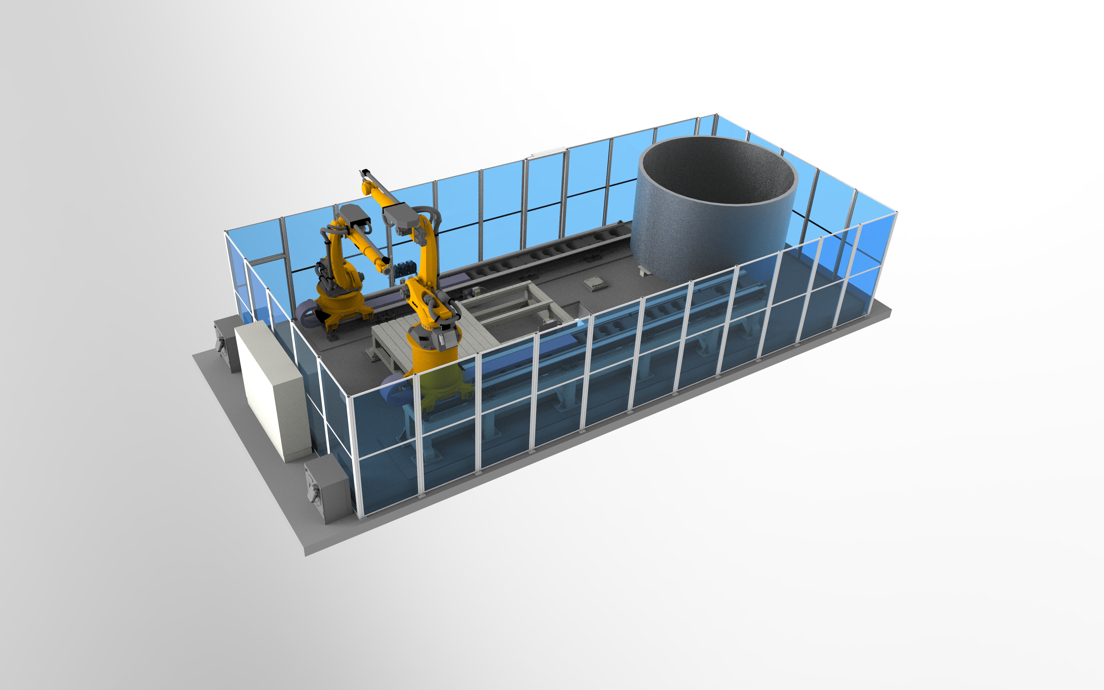

In 2016, with a view to building on the success achieved by the programme up to that point, the partners asked TWI to develop a much larger system in order to address the challenges associated with inspection of much larger aerospace components such as spars, wing skins and engine casings.  A further three year project, Intacom 2, was launched that will deliver a cell containing much larger robots and additional axes such as 14m tracks and a 4m turntable.  Groundwork is currently underway to reinforce the laboratory floor in TWI Wales to cope with the significant forces that such a fast, large system will produce.  The new system is expected to be fully installed by early 2019.
In order to maintain positional accuracy over such a large area, and to cope with variability in part shape and positioning within the cell, a combination of metrology systems is being developed.  Laser line scanners are deployed to generate surface profiles of real parts where CAD data is not available (such as for legacy parts) or does not sufficiently match the final part shape.  A photogrammetry system using eight waterproof cameras is used to monitor robot position and track movement, enabling any deviation from the intended paths to be identified and providing the option to make real time adjustments to the scan paths.  This is particularly important when scanning using ultrasound in through transmission mode, where sound is passed through the part from one robot to the other.  Here the relative positioning of the robots is critical, particularly when part surfaces are not parallel and require complex scan paths, and the robots do not simply mirror each other’s movements.

3D visualisation of new robot cell
Photograph of the existing, original Intacom robot
