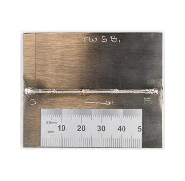

Electron Beam Welding tests
Since Electron Beam (EB) welding is intended to weld thick pieces, tests were carried out on 2.5mm, 30mm, and 60mm samples with different preheating to assess the influence of the thickness and preheat at high temperatures.
The sample sizes were chosen to provide a result on the depth that an EB weld could reach, with a belief that, with powerful enough EB welding equipment, test trials could see 100mm deep work pieces being easily weldable.
Figure 1: 2.5 mm deep EB welded plates

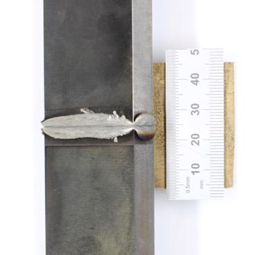

A previous study showed that AD730® can be joined using Linear Friction Welding (LFW) without causing liquation cracking. This early test was expanded upon at TWI.
Coupons of 10x40mm (400mm2) faying area and 127.5mm final length were welded to allow us to apply a pressure up to 600MPa at the highest force capability of the machine (250kN). Different friction pressure, amplitude, and frequencies were applied to the specimens before they were assessed to determine the optimum parameters for the quality of the weld.
The tests found that tensile properties seemed to slightly improve with post weld heat treatment. More mechanical tests are needed alongside research to assess other sets of pressure, amplitude, and frequency, as well as EDX inspection of the flash.
However, overall, it was found that LFW provides a fast rate of production and unique microstructure, which is best with a friction pressure of 350MPa and oscillations at 35Hz with an amplitude of 1.5mm.

Figure 2: Linear friction welded specimen
