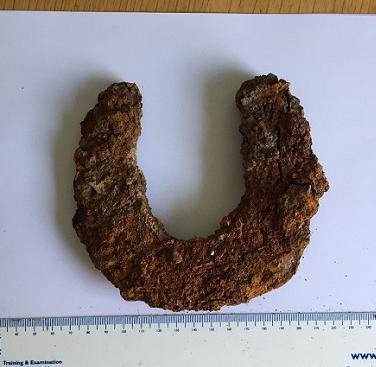

The heavily corroded horseshoe

The design of horseshoes has undergone a number of changes over the centuries, making it possible to apply a date to them. The arrangement of the nail holes and the overall shape of iron horseshoes have changed over the years, offering clues to help work out when they may have been made.
However, the horseshoe found at St. Catharine’s College was so badly corroded that the shape and nail holes could not be discerned without the use of an x-ray. It was therefore somewhat fortuitous that Professor Davenport discussed the find with alumna Eleanor Clapp while at a College dinner. Eleanor, in turn, advised that Professor Davenport sought the help of TWI Ltd, where her twin sister, Dr Philippa Moore, works as a materials and integrity engineer.

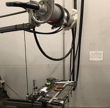

TWI has experience of using x-ray technology in forensic engineering investigations to assess components damaged by fire or corroded by subsea conditions, and so the horseshoe found its way to TWI’s headquarters just outside Cambridge.
Testing and findings

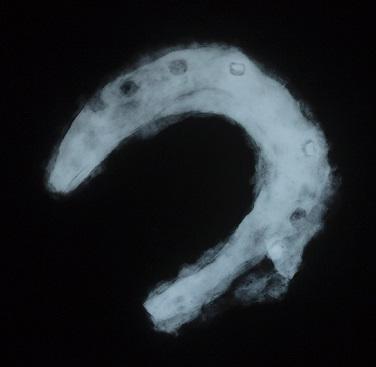

Non-destructive testing technician, Connor Brookfield from TWI’s Test House carried out an x-ray of the fragile and corroded horseshoe. The results showed the shape of the horseshoe beneath the corroded outer layer, including an arrangement of at least six nail holes with two seeming to still contain square headed nails.
The horseshoe showed a number of signs that would help to date it. Flat and without visible Calkins at the ends (Calkins are bent over ends of a shoe, more common among modern horseshoes), the horseshoe had an asymmetrical shape and a rounded arch. There was also no sign of a toe clip (a feature not invented until the mid-nineteenth century), nor any fullered groove running around the outer edge (fullering is very unusual on horseshoes dating before the mid seventeenth century). The St. Catharine’s horseshoe also showed no signs of the early seventeenth century trend of spreading inwards at the heel to create a keyhole-style inner profile.
Although there was significant variation in horseshoe styles across the country, earlier examples tended to have fewer nail holes; with late medieval shoes often having between six and eight holes, which would match the one found at St. Catharine’s.
So, could we prove that the horseshoe came from Hobson’s famous stables?
The x-rays offered a number of clues that showed the horseshoe could have come from the late sixteenth or early seventeenth century, placing it squarely within Thomas Hobson’s lifetime.
While it is impossible to be absolutely certain, TWI helped conclude that there is definitely a good chance that the St. Catharine’s College horseshoe may have once been worn by one of Thomas Hobson’s horses.
The horseshoe undergoes an x-ray
The x-ray clearly shows nail holes and other details
