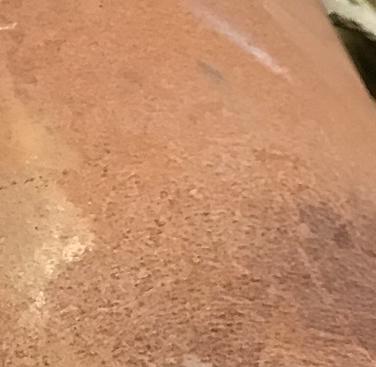

TWI’s client was procuring a set of mooring chains for an upcoming project. Shallow, crack-like indications were discovered on the crown region of two of the links, which were believed to have originated from the steel manufacture. The client wished to use an impartial company, such as TWI, to inspect the links, review the root cause analysis and report the findings.

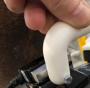

The eddy current array T-flex probe on a chain link.

Initially, MPI inspection was carried out using an alternating current (AC) electromagnetic yoke, with colour contrast (black) MPI ink, and a wet continuous method of application. After the MPI inspection, ECA was implemented. The ECA equipment manufacturers were consulted, and they advised the use of an I-flex probe with small coils to provide greater sensitivity.
The combination of ECA and MPI worked well together.  The two methods were equally sensitive, and both had a good probability of detection, detecting surface cracks as small as 2mm long and 0.6mm deep. However, on occasion the ECA picked up some crack like indications, which MPI did not, and vice versa.
During initial on-site inspections, it became apparent that the I-flex probe was unsuitable due to access constraints. TWI contacted the ECA manufacturer, who created a bespoke T-flex probe that was specifically tailored to have the required sensitivity for this project.

TWI successfully completed the on-site inspections. The ECA/MPI inspection programme found no additional indications. Therefore, TWI successfully used their impartial and qualitative judgment to assist their client in deciding that the chain was acceptable.
Eddy current array equipment on the mooring chain link.
