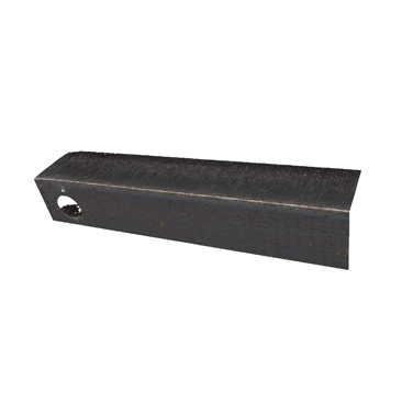

Figure 1 3D scan of an 8mm laser-cut carbon steel edge. The left hand side contains a through hole and a punch mark to aid scan alignment for later steps.

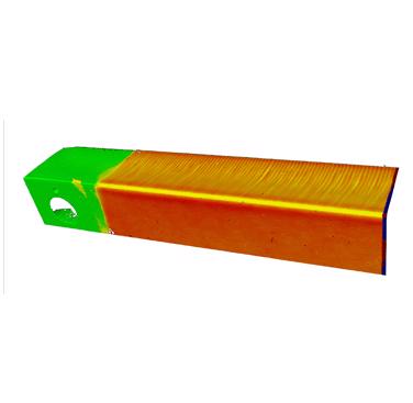

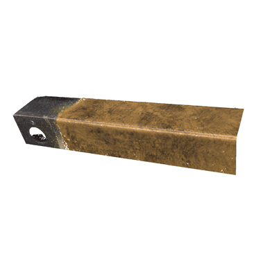

Figure 2 3D scan of the same sample having been powder coated. The left hand side was masked off to aid alignment with uncoated scan. [NB – powder coating has been modified to remove gloss, improving data collection from focus-variation microscope.]

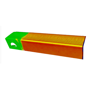

Figure 3 False colour representation of nearest neighbour distance between scans of coated and uncoated edges, mapped onto scan data of the coated edge. This distance measures the minimum coating thickness at any given location.

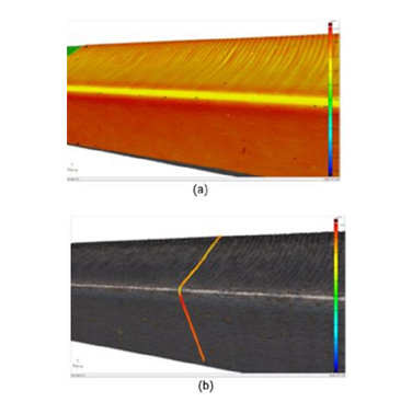

Figure 4 (a) Detail from false-colour height map of coating thickness showing the reduced coating thickness over the sharp edge and the peaks of striations on laser cut face and (b) intersection of 2D plane, showing coating thickness variation over the edge.

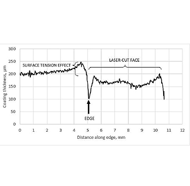

Figure 5 Plot of coating thickness as a function of linear distance along edge, showing how surface tension effects during powder coating result in material being drawn away from the sharp edge.
