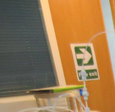

An exploratory project was funded by TWI to examine the effect of DO on the performance of 316L (UNS S31603) austenitic stainless steel (ASS) and 25%Cr (UNS S32750) super duplex stainless steel (SDSS) in saline solutions. In this project, pitting corrosion tests were carried out in solutions containing different levels of DO, chloride ion concentration, temperature, etc. A gas mixture, containing the required oxygen content, balanced with nitrogen, was used, and a bespoke test set-up was developed (see Figure 1). The DO was measured and recorded using an oxygen sensor during testing.

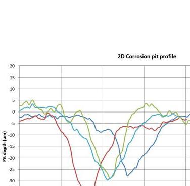

The experiments showed a clear influence of DO and temperature on localised corrosion. The surface finish and chloride content also had an effect. The increase in surface roughness resulted in pitting of the material (see Figure 2). The outcomes from this research investigation are documented in NACE Paper No. 9062.

Figure 1: Test set-up

Figure 2b: Effect of surface finish on pitting corrosion resistance of 316L in a salt solution (61g/L chloride ions) with a 100ppb DO: corrosion pit profiles obtained from the test specimen surface using surface profilometry method after pitting corrosion test
