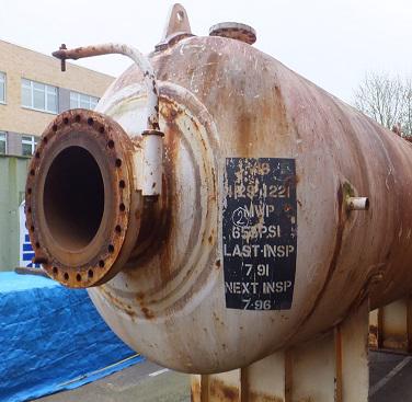

The published guidelines describe a process for screening vessels according to their risk of fatigue failure and provide a worked example of applying the process.  Where the need for an assessment of remaining fatigue life is established, the guidelines describe how this can be done, and the use of inspection and other options available when the design fatigue life is reached.  The guidelines also present studies made by two offshore operating companies assessing the risk of fatigue failure of their ageing pressure vessels (Figure 1).

Figure 1. Pressure vessel from the 1970s

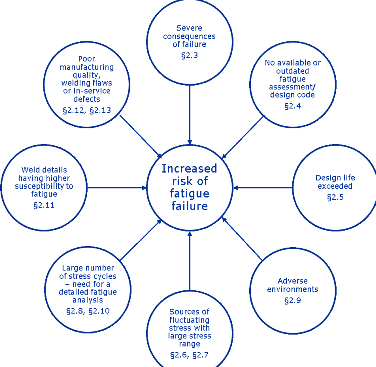

Fatigue risk factors
Factors increasing the risk of fatigue failure are summarised in Figure 2.  Welds are particularly susceptible to fatigue and should receive the most attention. In general, the presence of several concurrent risk factors should be a trigger for assessing fatigue in more detail.

Figure 2. Summary of key factors leading to increased risk of fatigue failure
