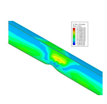

API 579 Part 12 outlines the level 3 dent assessment procedures. The procedures required the plastic collapse, local failure, buckling collapse, cyclic loading, creep and creep failure modes to be considered for the dent assessment. In this assessment, the creep assessment was not conducted, as the pipeline was not operated in the creep range. The pipeline was operated under constant internal pressure. Fatigue due to operating cycle was not significant.
The pipeline dent was potentially located in a free spanning region. The cyclic loading due to in-line and cross-flow VIV and direct wave may affect the integrity of the dent. However, the free spanning fatigue assessment was not covered in API 579 procedures. Instead, the fatigue screenings in DNV-RP-F105 procedures were used to address the free spanning fatigue assessment.

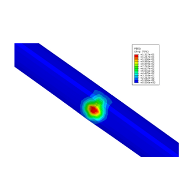

Dent deformation process was conducted by using an elastic-plastic finite element (FE) approach to determine the magnitude of permanent plastic strain that had developed. A strain assessment using ASME B31.8 Appendix R was performed to validate the accuracy and conservatism of the assessment.
Figure 1. Maximum principal stress for the load case (protection against local failure) - cross section view

API 579 and ASME B31.8 static loading assessment results.
The localised equivalent strain due to the dent was 13.3% against an ASME B31.8 allowable of 6%. In the API 579 level 3 assessment, the load case passed the plastic collapse and collapse from buckling assessment. However, acceptance for protection against local failure assessment was not proven. The maximum principal stress and plastic strain are shown in Figures 1 and 2.

The assessment results showed that the dent was not acceptable to API 579 level 3 requirements. The equivalent strain obtained from FEA was found to be unacceptable to the ASME B31.8 requirement. The DNV-RP-F105 VIV assessment showed that a dent in a 3m span was not significant with respect to fatigue.

Figure 2. Equivalent plastic strain distribution of the dent
