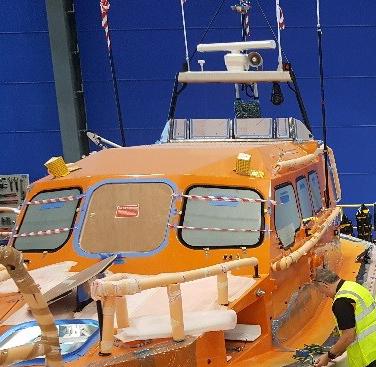

Figure 1 Shannon-class lifeboat being prepared for digital radiographic inspection

The most suitable approach that allowed the inspection of the entire hull-to-deck joint, including bulkheads, required that both the digital detector and the X-ray generator were positioned on the outside of the boat (Figure 1).

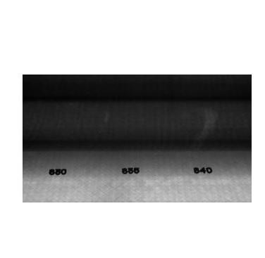

The interpretation of the radiographs revealed some internal features in the joint region. Figure 2 shows a radiographic image demonstrating minor flaws where the adhesive, injected from different points had not quite met, creating two small gaps.

Figure 2 Representative radiographic image showing minor flaws
