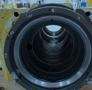

Figure 1: The component with marked sections 1-12

An eddy current flaw detector thread probe was used to scan the external thread.  To begin with, the sensitivity and phase were adjusted on a calibration specimen to ensure accuracy.  Then the phase angle was adjusted to give a horizontal lift-off vector.  Finally, the gain was added to achieve the full-screen height.  The same section of the thread was used to calibrate the ACPD equipment which was then used to measure the depth of a crack in either the root or flank of the threads.
The inspection was carried out by dividing the circumference of the component into 12 sections, then checking the response from the 0.2mm notch in the calibration specimen, after which the probe was placed inside the threads and component.  Subsequently, the probe was placed and balanced in the thread of the component.  To ensure full coverage, each thread in each section was scanned separately in turn, and overlapping with the next section.

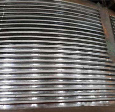

No deposits were visible on the inspected composite valve block body and the threads were in good surface condition.
The ECT inspection of the thread was successful as it detected several indications, two of which were below the reportable level.  However, due to the eddy current noise and unideal contact between the eddy current probe and the thread, it was recommended that the client consider using a magnetic particle inspection for the next stage of the project.
Figure 2: The threads showing good condition
