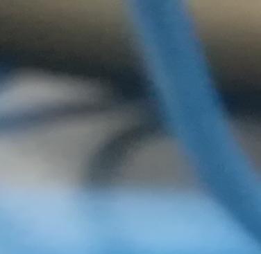

Prototype radiation resilient transducer

TWI performed a literature review to identify radiation resilient piezo-ceramics  together with methods of joining these crystals to a front wear plate. Trials were undertaken to assess the joining of the different material combinations identified, and the assemblies manufactured were tested in a gamma radiation environment to assess their radiation resilience.
The assemblies remained operational after exposure to ≈12MGy of radiation. Various design options and cabling solutions were investigated to develop an ultrasonic transducer; when the assemblies were incorporated into the prototype they were found to function well.

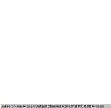

Ultimately, TWI was able to develop and manufacture an ultrasonic transducer that remained functional after a total radiation dose of ≈12MGy.

Ultrasonic response post irradiation (≈12MGy) (76mm calibration block)
