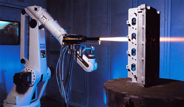

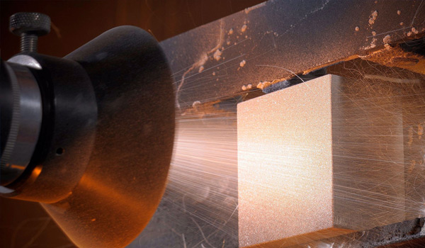

Thermal spraying can be used to deposit metals, cermets (such as WC-Co), ceramics, polymers in layers typically 60 μm to 10 mm thick, for a wide range of engineering applications. Conventional thermal spray techniques include flame spraying and electric arc spraying. These have been used since the mid-1900s and continue to be developed. More advanced thermal spray processes include detonation gun, high velocity oxy-fuel (HVOF), plasma and suspension/precursor spraying. Each process gives different coating characteristics for the same coating material, which determines the coating performance.
Almost any material can be deposited so long as it melts or becomes plastic during the spraying process. Blends of different materials to produce composite or graded thermal spray coatings are possible. At the substrate surface, the particles form 'splats' or 'platelets' that interlock and build up to form the coating.
The deposit does not fuse with the substrate or form a solid solution. The bond is primarily mechanical. Hence, adhesion depends on the molten particle impact velocity as well as the surface condition, which must be clean and roughened by grit blasting or machining prior to spraying. Bond strengths between ca. 10 MPa and >80 MPa can be obtained depending on the thermal spray process and spray parameters used.

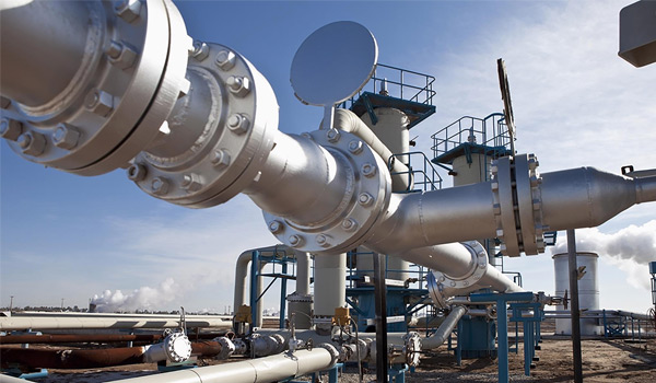

The lifetime and efficiency of geothermal heat exchangers are adversely affected by the presence of geothermal fluids, hot gases, and humidity in varying temperature conditions. Generally, expensive heat exchanger materials are used in these systems due to the corrosion and scaling threat, but the GeoHex project has been investigating coatings and surface modification solutions to improve heat transfer performance and guard against corrosion and scaling.
