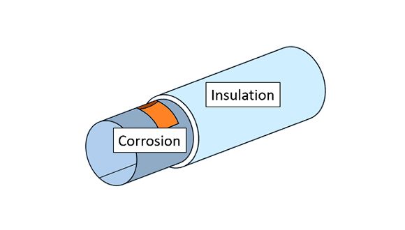

Corrosion may develop and grow on steel pipes under layers of insulation and cladding.
The multi-layered structure of a pipe, as visualised in Figure 1, complicates the inspection process of a corrosion under insulation.
Unlike the conventional non-destructive testing (NDT) techniques that require removal of the insulation, pulsed eddy current (PEC) offers the capability of non-contacting inspection, which consequently enables an in-situ technique to be devised.
However, responses from a PEC system are highly influenced by variations in the cladding and insulation thicknesses. Although recent works have established different approaches in compensating for these adverse effects on PEC responses [1], none of the techniques present an approach for in-situ measurement.
The aim here is to utilise a novel signal processing technique to overcome the variability in PEC signals due to variations in the cladding and thickness variations.
The results, validated by experiments, prove that the approach is effective in quantifying corrosion on pipes independent of confounding cladding and insulation thicknesses variations.
Figure 1. Corrosion on multi-layered pipe structure.

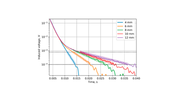

In the context of the PEC responses from the developed PEC system, |∇|-1 is extracted by computing the gradient of the signals within a specified thresholds.
Figure 2 demonstrates the extraction of the feature from a set of PEC signals of different wall thicknesses.
Figure 2. |∇|-1 features extracted from PEC signals.

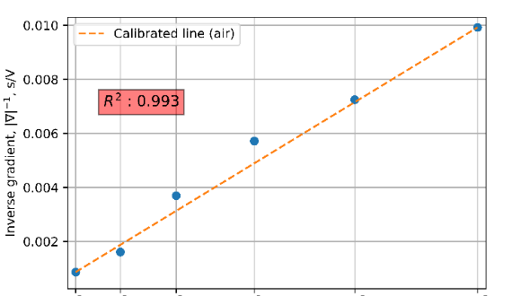

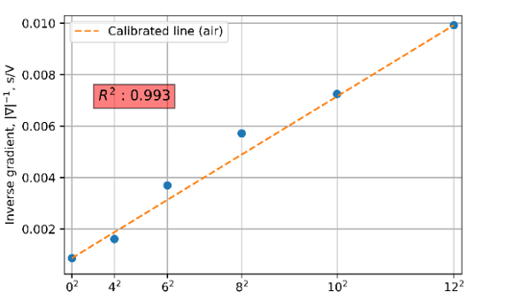

As equation (2) suggests, the linearity of the |∇|-1 feature with thicknesses is demonstrated in Figure 3.
Figure 3. Plot of extracted |∇|-1 against d2

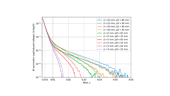

The effects contributed by different thicknesses of insulation are demonstrated in Figure 4.
As can be seen, for each wall thickness, despite the difference in the lift-off values, the PEC signals still decay at similar rates.
This shows up as a generally parallel shift in time.
Figure 4. PEC signals for different pipe wall and insulation thicknesses.

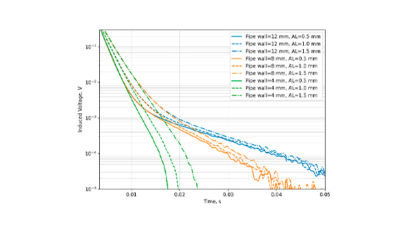

The effects of cladding thickness variations is demonstrated in Figure 5. Cladding thickness variations affect the early part of the signals, but can be said to diminish at the later part.
The signal gradients during this time range are also consistent corresponding to their thicknesses.

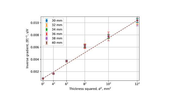

Figure 6 shows the extracted |∇|-1 values corresponding to different aluminium cladding and wall thicknesses.
The extracted |∇|-1 values, in general, can be said to be almost linear with the value of d2.
Although the aluminium cladding thickness is proven to affect the PEC signals, the linearity of |∇|-1 with respect to d2 is still maintained.
Moreover, the values of each |∇|-1 corresponding to respective wall thicknesses (irrespective of aluminium cladding thicknesses) are profoundly consistent, suggesting the immunity of the proposed |∇|-1 technique to the presence of aluminium cladding.
Figure 5. PEC signals for different pipe wall and cladding thicknesses.
Figure 6. Extracted |∇|-1 for different aluminium cladding thickness over different wall thicknesses.
