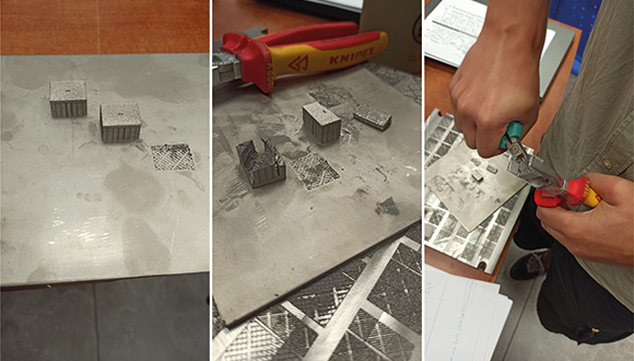

Images from Antonios Dimopoulos' experiments at Kanfit3D. Photo: Antonios Dimopoulos
Antonios said, "This article investigates and evaluates the various support and process parameters for metal LPBF systems, proposing optimized support structures that minimize the support volume, while supporting removal effort and warping deformation"
The optimization approach was based on the design of experiments methodology and multi-response optimization, by 3D printing and studying overhang geometries from 0° to 45°. For this purpose, EOS Titanium Ti64 Grade 5 powder was used, a Ti6Al4V alloy commonly employed in LPBF.
On 0° overhangs, the optimum solution was characterized by an average Tooth Height, large Tooth Top Length, low X, Y Hatching, and high Laser Speed, while for 22.5° and 45° overhangs, it was characterized by large Tooth Height, low Tooth Top Length, high X, Y Hatching, and high Laser Speed.
