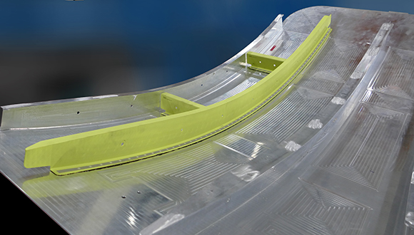

Refill friction stir spot welding in aerospace structures. Photo: TWI Ltd
The results from this study showed that the mechanical properties of the welds produced using refill FSSW without interfacial sealant were closely matched with the established joining technology for the aerospace industry, rivet joints.
As a novel point, from an academic point of view, the use of interfacial sealants, commonly used in the aerospace sector, improved the static and mechanical strength of the welds, surpassing the benchmark values for riveted joints.
