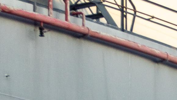

Steel pipelines at process plant. Photo: Unsplash
