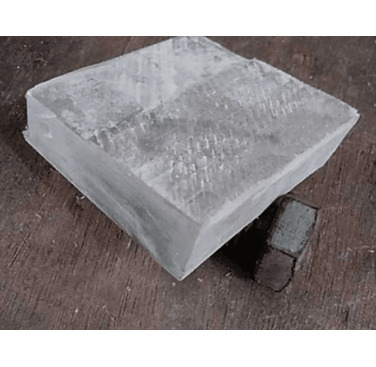

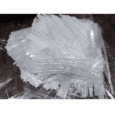

An early project milestone was accomplished when partner B. & M. Longworth used their DEECOM® process to reclaim clean glass fibres from decommissioned wind turbine blades (Figure 1).  An output of 100% glass fibre, completely free from the polymeric residue or debris usually associated with wind blade construction, was achieved (Figure 2), and this was confirmed by materials characterisation carried out by TWI and BCC.

Figure 1. S Segment of GFRP from end-of-life wind blade.
Figure 2. Clean glass fibre reclaimed via DEECOM®.
