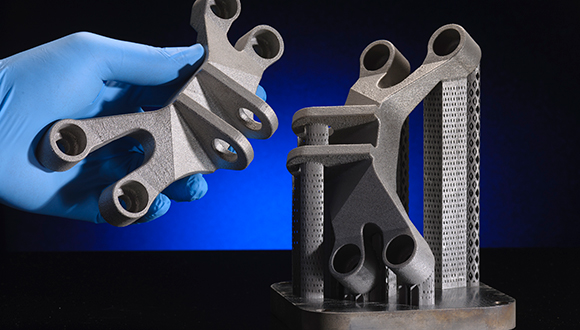

A free web-based software for metal laser powder bed fusion (PBF-LB/M) has been introduced by a team of researchers, including NSIRC PhD student Antonios Dimopoulos.
Available at no cost, the software is designed to generate appropriate support structures and predict the thermomechanical behaviour of a part under PBF-LB/M printing conditions, addressing the challenges of critical part construction and high process costs in the additive manufacturing (AM) industry.
PBF-LB is an advanced AM technology that produces thin, complex, and lightweight components for various sectors, including healthcare, automotive, defence, and aerospace.
Support structures play an equally significant role in PBF-LB/M, preventing defective and collapsed parts and reducing post-processing efforts. However, incorrect support selection or adding unnecessary supports leads to increased material usage and high thermal stresses, causing printing defects.
The web-based support generation and optimisation platform addresses these issues by allowing users to import 3D parts and generate block-type support structures with diamond perforations based on the PySLM library.
The software predicts the thermomechanical behaviour of a part during printing, ensuring high-quality prints, minimizing material usage, and reducing printing time. The software is fully interactive and accessible online at no cost.
