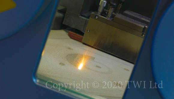

Additive manufacturing (AM) is a novel manufacturing process that produces parts through the deposition of material layer by layer.
There are a number of different types of AM processes from powder bed fusion (PBF) methods to direct energy deposition (DED) techniques. PBF utilises a build chamber in which a layer of powder is spread and selectively melted according to a CAD file of the desired geometry.
On the other hand, DED processes deposit molten material at the position of the heat source. These include processes such as wire-arc additive manufacturing (WAAM) and laser metal deposition (LMD).
AM is set to become a $21.5 billion industry by 2025 [1] due to the large range of benefits it offers, including high material usage, the development of complex geometries and customisation opportunities.
Figure 1: Laser Powder Bed Fusion. Image Courtesy of TWI Ltd

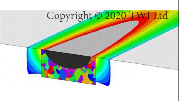

Figure 2: Overlap between FE thermal model and CA microstructure model
The modelling approach undertaken within this work implements a Cellular Automata (CA) - Finite Element (FE) model.
Finite element models are used to simulate the thermal history of the AM process on a continuum scale. This involves modelling the heat profile as well as accounting for the scanning strategy, material deposition and heat losses involved within the process.
Thethermal model is then imported into the CA model to drive grain growth in the microstructure simulations.
Cellular automata models make use of a grid of cells, where each cell is assigned a number of state variables. These are updated throughout the model according to a prescribed set of rules.
Within this microstructure model, these state variables and rules are defined to represent the physical solidification mechanisms that take place within AM processes, and are based upon those used in the model presented by Rappaz and Gandin [3] for casting applications.
Work is now being seen within literature to apply these models to additive manufacturing processes.
Results of the research
A 2D version of the modelling approach has been validated using open source data provided by the NIST laboratories [4]. The set up involved a single laser scan across a bare IN625 substrate.
A strong level of agreement was achieved and the approach was deemed to be successful. Furthermore a statistical analysis has been undertaken to evaluate the probabilistic effects of the microstructure model. Following this work we are now applying the model to a DED process.

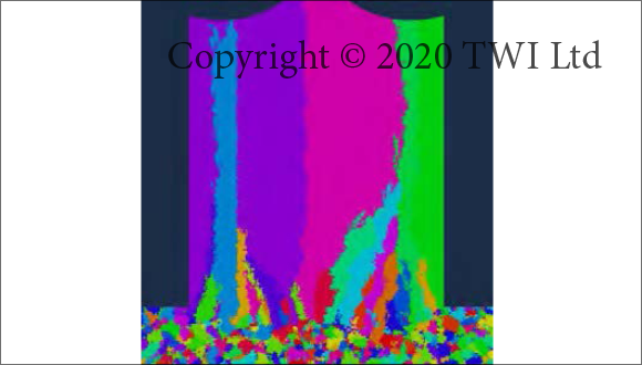

An extensively monitored experimental design has been undertaken, including thermocouple measurements, in order to validate FE thermal models before their implementation within the C models.
Figure 3: Example of an application of the CA model to a Wire- Arc Additive Manufacturing process
A good level of visual agreement was achieved between experimental EBSD images and simulated microstructures. Qualitative measurements have also been undertaken.
Discussion
Within this work the modelling approach has been validated against a simple benchmark study. Following the success of this it has been applied to a direct energy deposition process and successfully simulated the key grain characteristics within the build part.

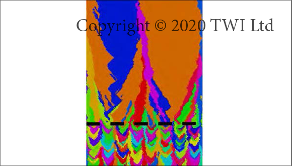

The modelling approach implemented here offers a wide variety of applications for the future, from the prediction of grain size to help determine the strength of a material to the prediction of microstructural transitions for the development of functionally graded materials.
Future adoption of the methods will see a growth in understanding surrounding the processes involved in these complex manufacturing technologies and help accelerate the safe implementation of these parts in industry.
Figure 4: Application of the model to a PBF microstructural transition
