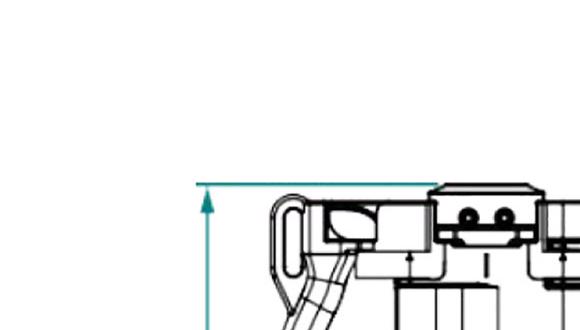

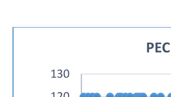

The recommended solution to address the concerns about the likelihood and severity of the external corrosion damage on both pipelines in this scope with regards to the limited access to the external surfaces of the pipes (due to the concrete coating) was a thorough inspection (100% coverage) using Pulsed Eddy Current (PEC) method as the main inspection technique followed by ultrasonic thickness measurement at the reported anomalies.

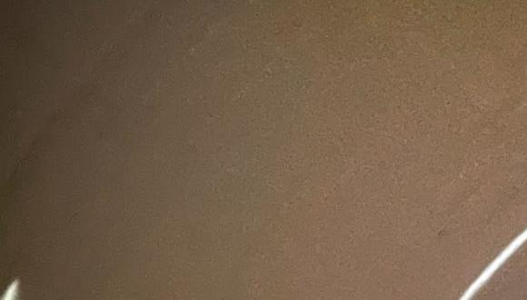

A full-coverage inspection was conducted internally at both pipelines to identify the pipeline conditions against identified threats and damage mechanisms. A number of parameters were priorities during the inspections to ensure the accuracy of the integrity approach. Three methods of inspection were carried out concurrently to identify the general integrity of the pipes with the emphasis on the external surfaces as the most susceptible areas to corrosion threat:
  • Visual inspection (VI):
  • Pulsed Eddy Current inspection (PEC)
  • Ultrasonic Thickness Measurement (UTTM)
Picture 2 – Six Channel Probe

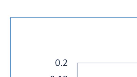

The results of the assessment reflect that the pipelines are generally in good condition. A few corrosion monitoring locations were identified to be inspected using NDT methods in recommended intervals. The conclusion of the results indicates that however the CP system could not be checked, it is working efficiently on both pipelines by providing an acceptable level of protection and keeping the external corrosion rate below the theoretically expected rate. Inspection intervals of 5 years and 10 years were recommended for the pipelines.
Picture 3 – Distribution of the minimum and maximum measured PEC Inspection Results alongside the pipe (inspection zones and quarters).
Picture 4 – Distribution of the remaining wall thickness along the pipe with minimum and maximum measured wall thickness data using UTTM grid scanning at the identified location (reported from PEC inspection)
Picture 5 –  Comparison of Theoretically Estimated Corrosion Rate against the Actual Calculated Corrosion Rate
