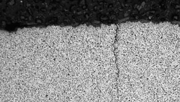

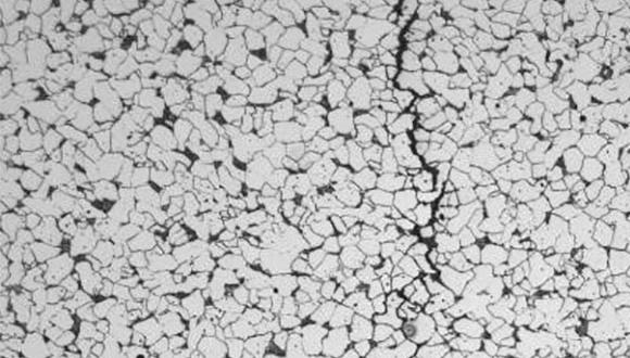

An on-site failure investigation was conducted on the tubes through a combination of analysis processes including:
  • Interpretation of failure location and service data
  • Examination of the parts to determine the failure mechanism
  • Engineering root cause, including design, fabrication, transportation, installation and service
  • Establishment of a non-destructive evaluation strategy for remaining components
The findings suggested
 that the cracking is considered to be a form of stress corrosion cracking (see Figure 1).

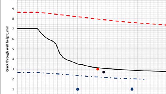

Fitness-for-Service and Integrity assessment
Finite element analysis and fracture assessment as per BS 7910 were performed on the affected headers and tubes using the TWI software CRACKWISE (see Figure 2). In summary, the results show that the components are fit for continued service.

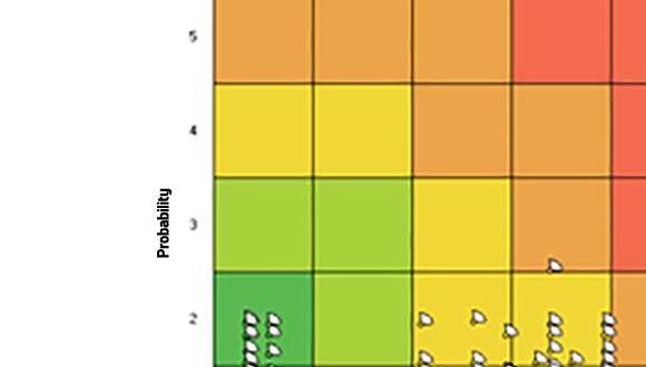

Risk-Based Inspection (RBI)
TWI also performed the risk Based inspection (RBI) on the HRSG components. The results of the assessment in terms of RLI (Run-length Indexes - TWI's safe future operating period based on risk) were presented. This is the basis for setting up an inspection interval and evaluate future inspection planning for safe continued service.
